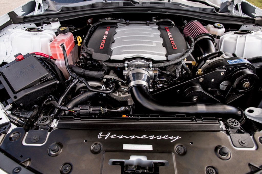

말그대로 1000 BHP(부하마력)을 뽑아낸 차져 킷인거 같은데 후덜덜 하군요.
http://www.hennesseyperformance.com
아래 항목들을 나중에 숩차 업그레이드시 참고할 만한 자료로 올려봅니다.
Power:
• 1008 bhp @ 6,500 rpm
• 918 lb-ft torque @ 4,000 rpm
Performance:
• 0-60 mph: 2.7 sec.
• 1/4 mile: 9.8 sec. @ 143 mph
• Top speed: 220+ mph
Includes:
• High-flow supercharger system.
• Extreme duty intercooler system.
• 416 CID Stroker motor.
• 4.0-inch Stroker crankshaft.
• Custom forged aluminum pistons with 11.5:1 compression ratio & steel wrist pins.
• 6.125-inch Billet steel H-beam connecting rods with ARP bolts.
• Balance, blueprint & assemble shortblock: fully de-bur block, line hone block with ARP main studs, deck block.
• Bore block on 3-axis CNC mill, hone block with torque plates, balance crankshaft, check bearing clearances.
• Assemble shortblock.
• CNC Ported Cylinder Heads ports- Competition valve job, extensive flow testing, chambers milled to desired cc.
• Lightweight hollow stem intake valves, exhaust valves.
• Extreme duty dual valve springs.
• Titanium retainers, machined locators & locks, GM valve seals.
• Chamber volumes measures & adjusted for compression.
• CNC work hand blended into valve job, spring pressures measured & adjusted.
• HPE hydraulic roller camshaft upgrade.
• Hydraulic lifter upgrade with extreme duty pushrods.
• 1.75 inch stainless steel long-tube headers.
• Stainless steel mid-pipe exhaust upgrade.
• High-flow catalytic converters.
• HPE engine management upgrade & chassis dyno calibration.
• Professional installation and all necessary gaskets & fluids.
• Chassis dyno testing.
You’ll receive a before & after dyno graph report showing power and torque measured at the rear wheels.
• Road testing (up to 100 miles).
• Hennessey exterior badge (rear).
• HPE1000 Powered by Hennessey badges (side & rear).
• Hennessey serial numbered plaque signed by John Hennessey (interior).
• Hennessey serial numbered plaque signed by the HPE technician (engine bay).
• Powered by Hennessey premium floor mats.
• Serial numbered Certificate of Authenticity personally signed by John Hennessey.
• Free lifetime membership in the official Hennessey Vehicle Registry (HVR).
• 1 Year / 12,000 mile limited warranty. Contact a Hennessey Performance sales associate for more details.
• Half of a tank of Shell V-Power 93 octane gasoline.
• Pennzoil Ultra Platinum synthetic oil & filter change.
아래 영상은 0~273Km/h 가속력 테스트 영상입니다

이것도 인스톨 해놓은거보면 엔진룸이 참 깔끔
