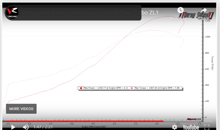

Huron Speed is happy to introduce our new Twin Turbo system for the 2016+ Camaro SS and ZL1 platforms! After extensive design and testing we have finally released our twin turbo system to fit all of your needs from some small boost to your LT1 or 1250+ rwhp to your built engine setup! This setup also will fit all transmissions including the manual trans, A8 and even A10!
This system was certainly a difficult one which is why it took so long to release, however we have now confirmed all bases and tested the system up to 1258 rwhp on our ZL1 in collaboration with Vengeance Racing!

We sent our 2018 ZL1 A10 equipped car bone stock down to our friends at Vengenace Racing supplying them with our prototype kit fitted with a pair of Comp Billet 6871 Turbochargers and Turbosmart Components. Vengeance completed the installed with the addition of many other upgrades to show off the ability of the kit. We actually have more room in the system for power, but recently changed housings down to the .82's to bring the power in a little quicker. We landed at 1258 rwhp through the 3" air filters and full exhaust out the back on 25psi. Track results are pending as we quickly found the limits of the A10 transmission and are working on that now to head back to the track! The owner of Vengeance had nothing but great things to say about the Turbo system and its flawless performance which speaks volume coming from a shop as high caliber as Vengeance Racing!
셋 구성이 깔끔하네요
그래프도 ㅎㄷㄷㄷ
