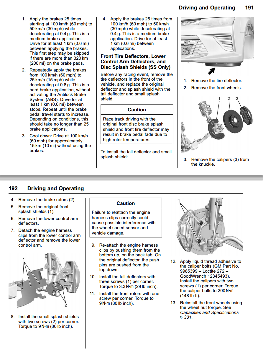

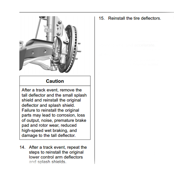

GM메뉴얼에 이렇게 나와있네요. ㅎㅎ
차 길들이기 할때 참고하시면 좋겠지요? 차나오자 마자 트랙들어가실꺼 같지는 않지만 ^^
Track Events and Competitive Driving
1.) The Engine Sound Management setting (if equipped)
should not be set to “Stealth Mode” during track events
and competitive driving.
- 앤진 사운드를 스텔스 모드로 놓지 말것 (안타깝게도 저희는 가변배기가 아니라서 ㅠㅠ 상관없네요)
Engine Oil
2.) If you use the vehicle for racing or other
competitive driving, the engine may use more oil
than it would with normal use. Low oil levels can
 damage the engine.
- 레이싱이나 경쟁모드일때, 앤진은 좀더 많은 오일을 사용합니다. 낮은 오일 레벨은 앤진에 데미지를 줍니다.
Be sure to check the oil level often during
racing or other competitive driving and keep
the level at or near the upper mark that shows
 the proper operating range on the engine oil dipstick.
- 레이싱 도중에도 자주 오일 레벨을 체크해주시고, 딥스틱의 가장 위쪽마크..(Full) 정도로 유지해주세요.
Rear Axle Fluid
3.) Axles must have 2400 km (1500 mi) before
 being used in track driving. The rear axle fluid
 temperatures may be higher than when driving
 in severe conditions. Drain and refill with new
 fluid after the first racing or competitive driving event,
and then after every 24 hours of racing or competitive driving.
-  2400km 정도는 타주고 트랙에 들어가세요. 데후오일 온도가 크게 올라갈수 있습니다. 첫 트랙이나 경주를 하고서는 새로 갈아주세요, 그뒤는 24시간의 레이스타임주기로 갈아주면 됩니다.
During a first time track or racing event, high rear axle
 temperatures can occur. Damage could be caused to
the rear axle and would not be covered by the vehicle
 warranty. Do not drive as long or as fast the first time
 the vehicle is driven on the track or raced.
-첫 트랙경주세서는 대후온도가 매우 올라갈수 있습니다. 이럴경우 손상이 갈수 있으며, 워런티는 거절 됩니다. -.-
 첫 트랙경주서는 적당히 달리세요 ㅡ.ㅡ
Brake Fluid
4.) For track events or competitive driving,
it is recommended that the brake fluid be replaced
 with a high performance brake fluid that has a dry
 boiling point greater than 279 °C (534 °F).
 After conversion to the high performance brake fluid,
 follow the brake fluid service recommendations
outlined by the fluid manufacturer.
 Do not use silicone or DOT-5 brake fluids.
- 브래이크액은 좋은거 쓰시고 DOT-5는 쓰지마세요.
Brake Burnishing
5.) To prepare the Camaro brake systems for
 track events and racing, complete the appropriate
 high performance brake burnishing procedure
 described below. New brake pads must be burnished
 before racing or competitive driving.
These procedures are specific to the Camaro SS,
 or LT with Y4Q Heavy Duty Cooling System that is
 equipped with J55 brakes. This
procedure should not be run on other Camaro models
 as damage may result.
 아래 기술한거 같이 브래이크 길들이기를 해주세요. SS니까 꼭 하세요.
When performed as instructed, this procedure will not
 damage the brakes. During the burnishing procedure,
 the brake pads will smoke and produce an odor.
 The braking force and pedal travel may increase.
After the procedure is complete, the brake pads may
appear white at the rotor contact. Run this procedure
 in a safe manner and in compliance with all local
and state ordinances/laws
regarding motor vehicle operation.
 Run this procedure only on dry pavement.
Racing/Track Brake Burnishing Procedure
Brake pedal fade will occur during this track burnish
 procedure and can cause brake pedal travel and
 force to increase. This could extend stopping distance
 until the brakes are fully burnished.
